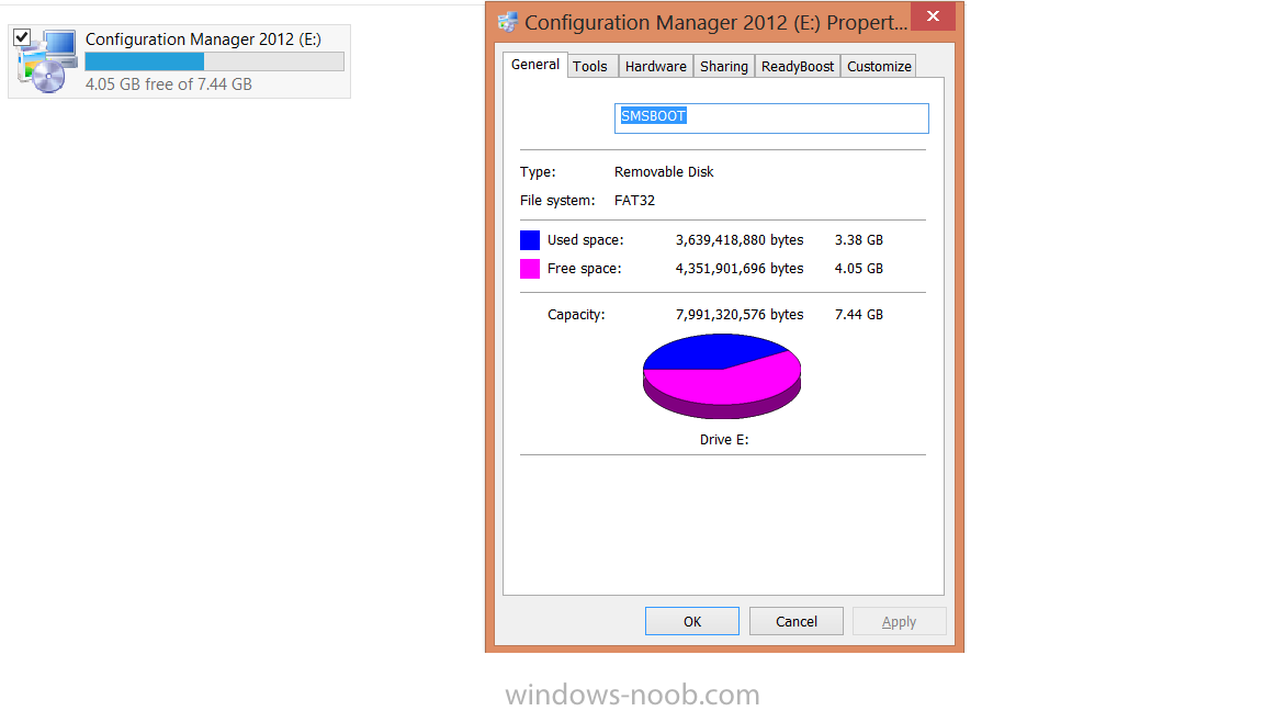

if i get time this evening i'll examine (and test booting from) my usb key, i'll also verify the file format on it for you guys.,..
ok i shutdown my Surface Pro, connected the 8gb kingston data traveller directly to my usb port, pressed and held down volume down on the left of the surface, and then briefly pressed the power button, it booted from my usb key
the key is formatted by configmgr and is FAT32
I finally got it to work using an 8GB Lexar FAT32 drive. Looks like my issues was creating the standalone media to CD/DVD set and not directly to the USB drive. All of my testing was done using the media created this way. Then I was copying the files from the share to a USB drive. Odd that it would boot on other devices, but not the Surface. Either way, it is working and another reason I should follow directions better.
