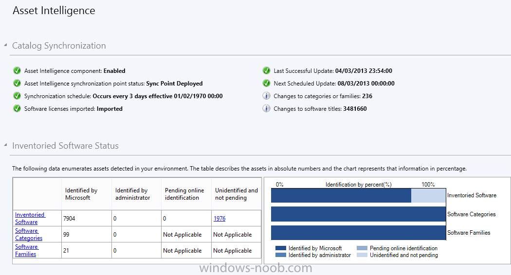

CM seems to be logging all inventoried software as it shows over 9800+ items. And as you can see from the attached file the Asset Intelligence point seems to be installed correctly.
Client settings have been configured to enable hardware inventory.
However when I try and pull software a report on any type of software, it only gives me the result for the software on one specific machine on our domain. its as if it only can see one machine on the domain.
So if I try and run a report for all versions of solid edge, it only returns result if it is installed on the machine "jl-wpark"!
Any ideas or anything else I need to check?
That is a Software Inventory report which has nothing to do with either AI or Hardware Inventory. BTW I always recommend not enabling SW inv. There is just too much overhead and very little gain.
You should look at Count of all instances of software registered with Add or Remove Programs instead.
