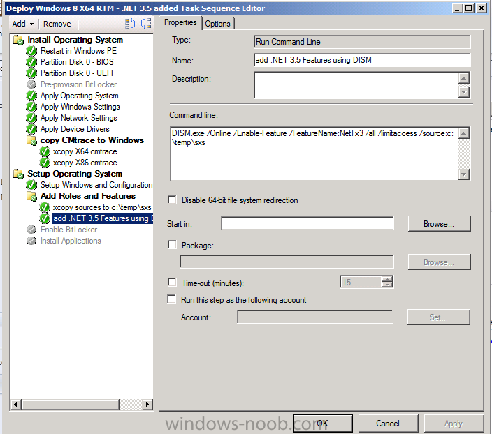

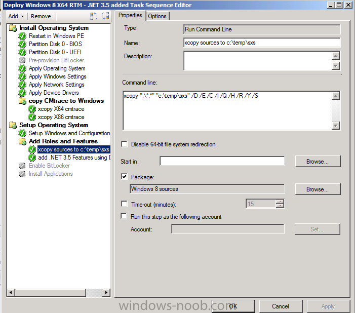

i copy the files to a local temp folder and then install from there, i'll post the steps when i get home and get access to my lab

what version of Windows 8 are you using ? and are you using the SXS folder from the same media that was used to install Windows 8

You can do it like anyweb, or copy the directories to the wim. We chose to copy them, they aren't that big in the grand scheme of things, and who knows if we will need them later down the road. For 64 bit you need to disable 64 bit file system redirection for it to work.
