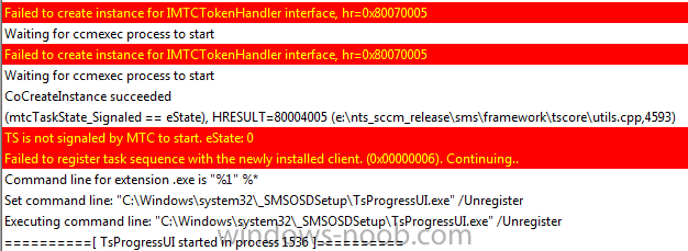

OSD Failed to create instance for IMTCTokenHandler interface, hr=0x80070005
I get the above error in my OSD task sequence.This happens after is has installed the configmgr client if I add applications they seem to install ok and then it errors again.
The log file contents:
<![LOG[install succeeded. Blocking other instances of ccmsetup.]LOG]!><time="22:59:52.026-60" date="03-16-2013" component="OSDSetupHook" context="" type="0" thread="2072" file="installclient.cpp:1097">
<![LOG[installed Client]LOG]!><time="22:59:52.026-60" date="03-16-2013" component="OSDSetupHook" context="" type="0" thread="2072" file="installclient.cpp:1155">
<![LOG[start to cleanup TS policy]LOG]!><time="22:59:52.026-60" date="03-16-2013" component="OSDSetupHook" context="" type="0" thread="2072" file="utils.cpp:3055">
<![LOG[TS Deleted 0 instances]LOG]!><time="22:59:52.463-60" date="03-16-2013" component="OSDSetupHook" context="" type="0" thread="2072" file="utils.cpp:3098">
<![LOG[TS Policy cleanup done]LOG]!><time="22:59:52.463-60" date="03-16-2013" component="OSDSetupHook" context="" type="0" thread="2072" file="utils.cpp:3099">
<![LOG[End TS policy cleanup]LOG]!><time="22:59:52.463-60" date="03-16-2013" component="OSDSetupHook" context="" type="0" thread="2072" file="utils.cpp:3103">
<![LOG[setting variable to indicate a client installation was done]LOG]!><time="22:59:52.463-60" date="03-16-2013" component="OSDSetupHook" context="" type="0" thread="2072" file="installclient.cpp:1166">
<![LOG[Registering the task sequence with the execution manager in the newly installed operating system.]LOG]!><time="22:59:52.495-60" date="03-16-2013" component="OSDSetupHook" context="" type="0" thread="2072" file="installclient.cpp:1170">
<![LOG[Active request handle is empty, registering with new active request handle. This is expected if the TS was started from a media/PXE.]LOG]!><time="22:59:52.495-60" date="03-16-2013" component="OSDSetupHook" context="" type="2" thread="2072" file="utils.cpp:4522">
<![LOG[saving the new active request handle for the task sequence: {7994ECED-7413-4ECE-A7ED-E6273E52257A}]LOG]!><time="22:59:52.495-60" date="03-16-2013" component="OSDSetupHook" context="" type="1" thread="2072" file="utils.cpp:4535">
<![LOG[Failed to create instance for IMTCTokenHandler interface, hr=0x80070005]LOG]!><time="22:59:52.573-60" date="03-16-2013" component="OSDSetupHook" context="" type="0" thread="2072" file="utils.cpp:4552">
<![LOG[Waiting for ccmexec process to start]LOG]!><time="22:59:52.573-60" date="03-16-2013" component="OSDSetupHook" context="" type="0" thread="2072" file="utils.cpp:4553">
<![LOG[Failed to create instance for IMTCTokenHandler interface, hr=0x80070005]LOG]!><time="22:59:57.604-60" date="03-16-2013" component="OSDSetupHook" context="" type="0" thread="2072" file="utils.cpp:4552">
<![LOG[Waiting for ccmexec process to start]LOG]!><time="22:59:57.604-60" date="03-16-2013" component="OSDSetupHook" context="" type="0" thread="2072" file="utils.cpp:4553">
<![LOG[CoCreateInstance succeeded]LOG]!><time="23:00:04.213-60" date="03-16-2013" component="OSDSetupHook" context="" type="0" thread="2072" file="utils.cpp:4564">
<![LOG[Launching command shell.]LOG]!><time="23:00:04.776-60" date="03-16-2013" component="OSDSetupHook" context="" type="1" thread="2092" file="debugwindow.cpp:202">
<![LOG[Windows station: WinSta0]LOG]!><time="23:00:04.776-60" date="03-16-2013" component="OSDSetupHook" context="" type="1" thread="2092" file="utils.cpp:43">
<![LOG[Desktop: Default]LOG]!><time="23:00:04.776-60" date="03-16-2013" component="OSDSetupHook" context="" type="1" thread="2092" file="utils.cpp:62">
<![LOG[executing command: D:\WINDOWS\system32\cmd.exe /k]LOG]!><time="23:00:04.776-60" date="03-16-2013" component="OSDSetupHook" context="" type="1" thread="2092" file="debugwindow.cpp:63">
<![LOG[executed command: D:\WINDOWS\system32\cmd.exe /k]LOG]!><time="23:00:04.792-60" date="03-16-2013" component="OSDSetupHook" context="" type="1" thread="2092" file="debugwindow.cpp:80">
<![LOG[succesfully registered the tasksequence with the execution manager]LOG]!><time="23:00:06.510-60" date="03-16-2013" component="OSDSetupHook" context="" type="1" thread="2072" file="utils.cpp:4597">
<![LOG[Command line for extension .exe is "%1" %*]LOG]!><time="23:00:07.620-60" date="03-16-2013" component="OSDSetupHook" context="" type="0" thread="2072" file="commandline.cpp:228">
<![LOG[set command line: "D:\WINDOWS\system32\_SMSOSDSetup\TsProgressUI.exe" /Unregister]LOG]!><time="23:00:07.620-60" date="03-16-2013" component="OSDSetupHook" context="" type="0" thread="2072" file="commandline.cpp:731">
<![LOG[Executing command line: "D:\WINDOWS\system32\_SMSOSDSetup\TsProgressUI.exe" /Unregister]LOG]!><time="23:00:07.620-60" date="03-16-2013" component="OSDSetupHook" context="" type="1" thread="2072" file="commandline.cpp:827">
<![LOG[==========[ TsProgressUI started in process 1984 ]==========]LOG]!><time="23:00:07.807-60" date="03-16-2013" component="TsProgressUI" context="" type="1" thread="2332" file="winmain.cpp:330">
<![LOG[unregistering COM classes]LOG]!><time="23:00:07.807-60" date="03-16-2013" component="TsProgressUI" context="" type="1" thread="2332" file="winmain.cpp:204">
<![LOG[shutdown complete.]LOG]!><time="23:00:07.823-60" date="03-16-2013" component="TsProgressUI" context="" type="1" thread="2332" file="winmain.cpp:512">
<![LOG[Process completed with exit code 0]LOG]!><time="23:00:07.823-60" date="03-16-2013" component="OSDSetupHook" context="" type="1" thread="2072" file="commandline.cpp:1123">
<![LOG[successfully unregistered TS Progress UI.]LOG]!><time="23:00:07.823-60" date="03-16-2013" component="OSDSetupHook" context="" type="1" thread="2072" file="utils.cpp:2320">
<![LOG[Moving logs to SMS client directory]LOG]!><time="23:00:07.823-60" date="03-16-2013" component="OSDSetupHook" context="" type="1" thread="2072" file="basesetuphook.cpp:1495">
<![LOG[LOGGING: Resetting log path.]LOG]!><time="23:00:07.823-60" date="03-16-2013" component="OSDSetupHook" context="" type="1" thread="2072" file="tslogging.cpp:1803">

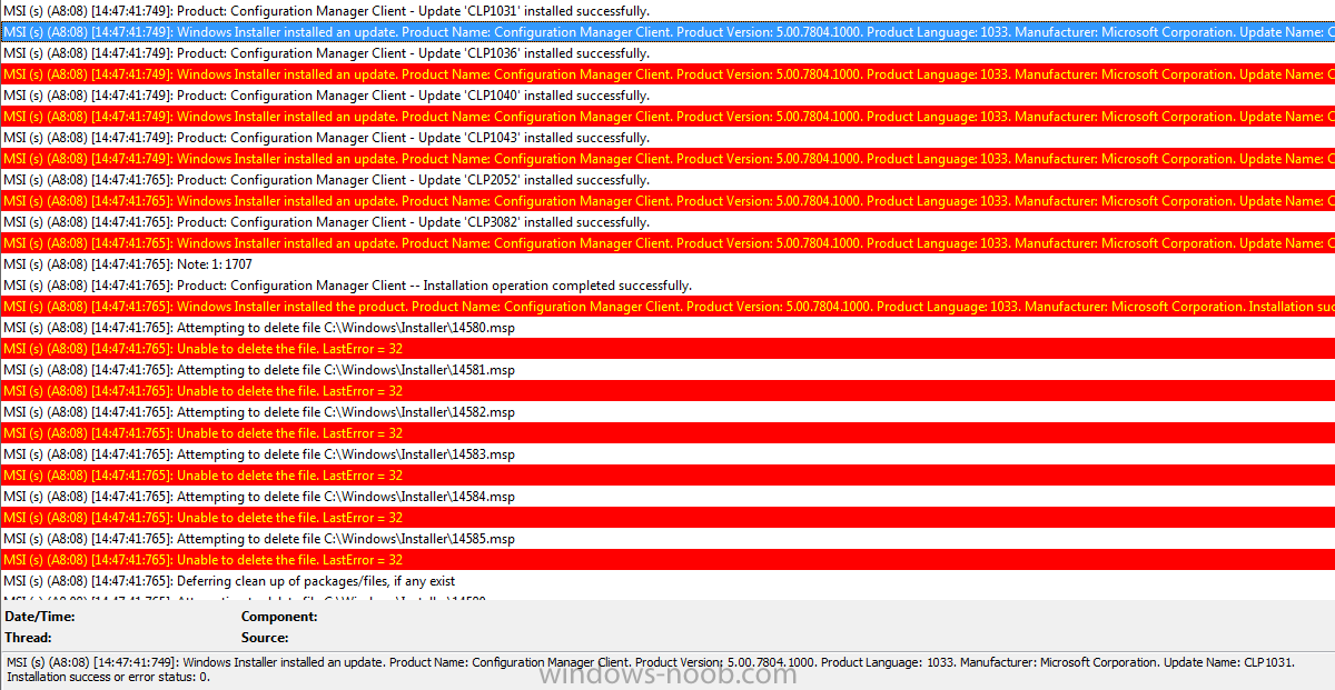

Hello,
I have pretty much the same problem (SCCM 2012 SP1)
I can not install any application during my build and capture task sequence.
I attached some content from the smsts.log and clientmsi.log
If anyone has an idea ?
Thank you.
Well I think it's because of my Network Access Account but It's already defined in the SCCM configuration and I still get the following message in the DataTransferService.log.
I am going to change my network access account, I hope It will work
[CCMHTTP] ERROR: URL=http://XXXXXXXXX:80/SMS_DP_SMSPKG$/Content_45b86d06-8f1e-4f13-a62b-53d97255501b.1, Port=80, Options=224, Code=0, Text=CCM_E_BAD_HTTP_STATUS_CODE DataTransferService 24/04/2013 17:59:11 1592 (0x0638)

Error sending DAV request. HTTP code 401, status 'Unauthorized' DataTransferService 24/04/2013 17:59:11 1592 (0x0638)
GetDirectoryList_HTTP('http://XXXXXXXXX:80/SMS_DP_SMSPKG$/Content_45b86d06-8f1e-4f13-a62b-53d97255501b.1') failed with code 0x80070005. DataTransferService 24/04/2013 17:59:11 1592 (0x0638)
Job {21180503-3F08-4FF6-819F-5FF0DEA33707} impersonating Network Access Account. DataTransferService 24/04/2013 17:59:11 1592 (0x0638)
[CCMHTTP] ERROR: URL=http://XXXXXXXXX:80/SMS_DP_SMSPKG$/Content_45b86d06-8f1e-4f13-a62b-53d97255501b.1, Port=80, Options=224, Code=0, Text=CCM_E_BAD_HTTP_STATUS_CODE DataTransferService 24/04/2013 17:59:13 1592 (0x0638)
