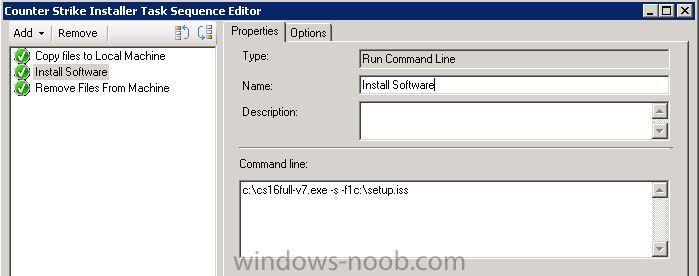

Had similar trouble with software that used similar commands and setup.iss file.
What I ended up doing was creating a custom Task sequence with 3 tasks in it.
1: A batchfile that copies the files including the setup.iss to the C:\Drive of the targeted clients
2: A commandline with the parameter c:\setup.exe -s -f1c:\setup.iss
3: A batch file that removed the files from the C:\Drive once the software completed
Not very native but it works!
There are probably better ways to this, but like you I could not get the software to install using a standard package.
You could try and put all the above steps into one batch file so then you would only have one package and use the start /wait command to call the next step!!
