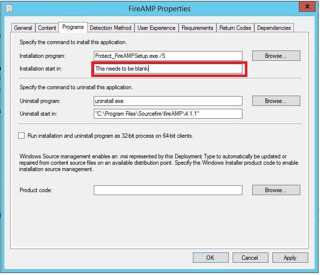

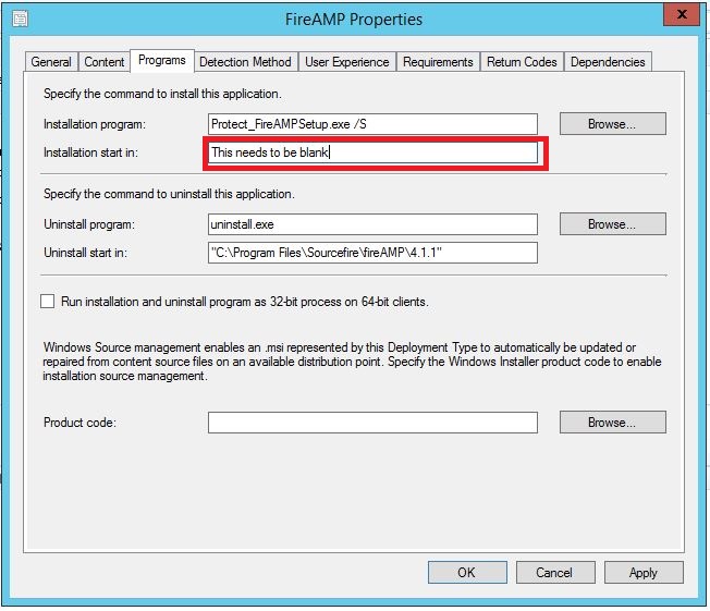

I know its been inactive for a while but I had the same error trying to deploy an application.
I traced the error to the "installation start in" path being put in when I created the deployment type. Once this was removed the application would install correctly.
Just thought this info might help someone else along the way.
