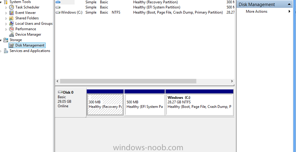

In the format UEFI task sequence step, I added the 'Make boot drive' to disk 0 GPT which resolved the issue. (Shown below with most of the deployment task sequence I used (minus applications/packages):
(Since I'm in a sharing mood: for those of you curious about the misspelled 'Assign C:\ Boot Drive' this is a left over from Windows 7. I didn't try the task sequence without it but I suspect i still needed it. See here for details.)
Another side note: when capturing the windows 8 image, i noticed it made a 1-1 and a 2-2 image. 2-2 had my OS. I didn't run into any issues because i noticed this but it is easy to miss otherwise.
