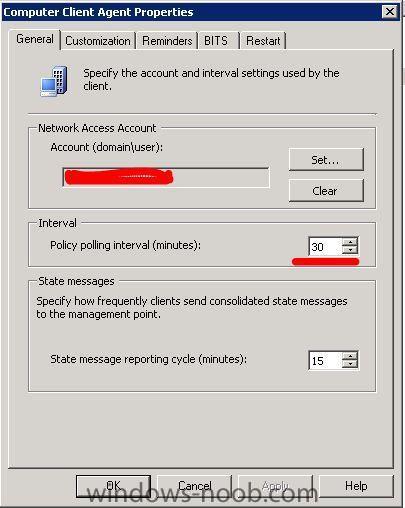

Hm these problems should disapear if you have your clients uppdating their policys frequently.
The polling interval can be set in the "computer client agent properties" found under client agents.

Hey thanks for your response. I have read up on the article and downloaded the tools. I have ran the tool and checked the logs, apparently the advertisement was deleted and not available since last year, if this is the case from running one of these tools, why would it have ran. The refreshing of the policy has been updated to update every 1 hour. I will see if this helps , and takes care of the issue. Would a client likely to cache a advertisement and then continue to run it even after it has been deleted and disabled.
