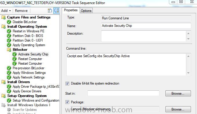

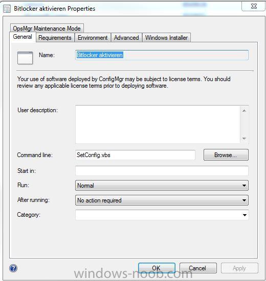

Than i create a softwarepackage “Bitlocker aktivierung” with Source Folder \\Server\Share\Locationofvbs and the following programs “Bitlocker aktivierung"
” Commandline setconfig.vbs
Than I edit my TaskSequence, add a Run Command Line step:
Cscript.exe SetConfig.vbs SecurityChip Active and I enable Packages and choose my “Enable bitlocker” package.
Than I deploy it, but it don't work:
I get the error message at step activate security chip:
Task Sequence has failed with the error code (0x80041017). For more informations, contact....
Any ideas? Many thanks in advance for your ideas
