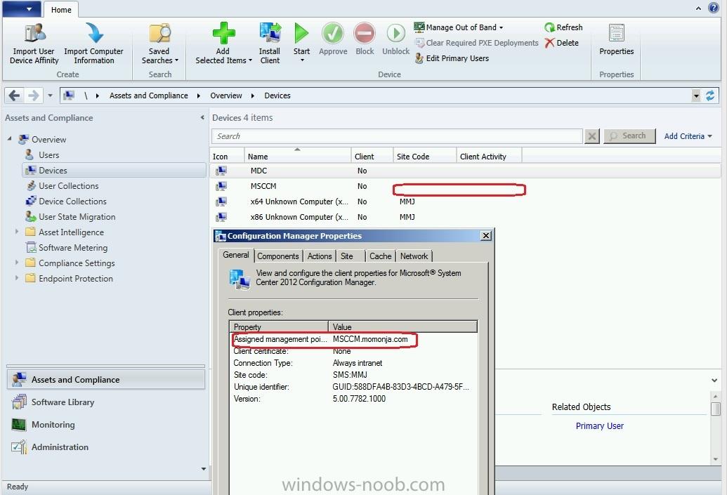

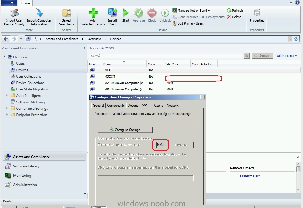

I have the same problem. When I tried pushing the same client agent using the Client push installation on SCCM 2012 console. The configuration manager does not appear on the control panel
Here is the setup of my test environment
Site Server = MSCCM
Site Code = MMJ
1. Active Directory schema has been extended
2. System Management has been created on System container on ADSI Edit
3. SiteServer has been given full control on the system management folder
4. Added the Configuration Manager admin template on the GPO and set the Site Code on MMJ
5. 2 Boundaries has been created.
  • IP Subnet = 192.168.0.0
  • IP Address Range = 192.168.0.1 - 192.168.0.254
6. Client Push installation settings has been modified.
7. Fall back server roles has been added.
8. Hierarchy settings has been configured to use fall back site.
I viewed the taskmanager on the client(which is my AD) that is being pushed by Client push and the ccmsetup.exe does appear but still the installation failed. Also, I did manual installation of client agent on the site server, configuration manager appeared on the control panel but the site server is not reporting to the sccm console. Attached is the screenshots of the configuration manager on control panel for my site server.
