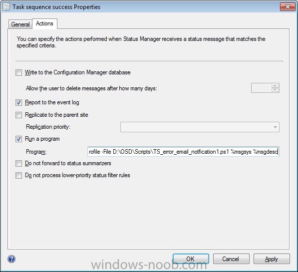

I have just set up a filter rule to email me the status of software deployments by running a powershell script.
I am currently passing the name into the powershell script by using this command
script.ps1 %msgsys
then within the first line of powershell i use
param([string]$strComputer)
This is working fine. I also wanted to pass the variable for message description so the script was
script.ps1 %msgsys %msgdesc

With PowerShell 2.0 you can bypass the security policy with :
C:\WINNT\SysWOW64\windowspowershell\v1.0\powershell.exe -executionpolicy bypass -file E:\Powershell_scripts\OSD_Provisioning_SCCM\email_OSD.ps1 %msgsys
After a hour of testing I found out that you must add double quotes around "%msgdesc" to get the full description.
Example of how my command line works:
"C:\Windows\SysWOW64\WindowsPowerShell\v1.0\powershell.exe" -executionpolicy bypass -file "D:\scripts\Dcreation.ps1" -message "%msgdesc"
