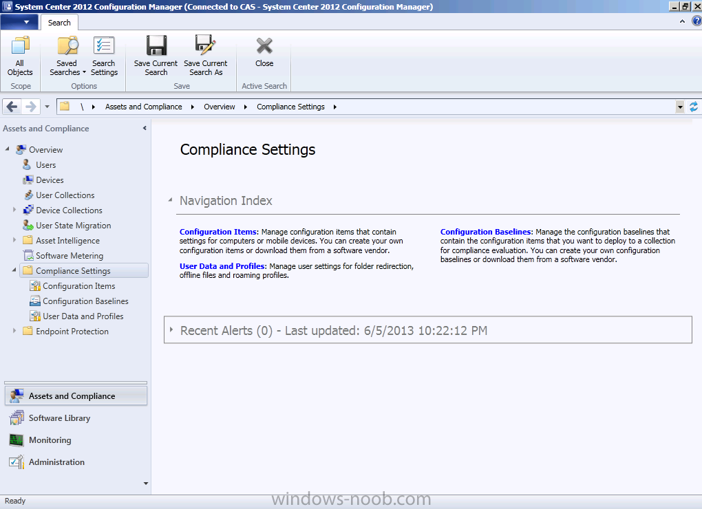

Configuration Manager 2012 Service Pack 1 has Compliance Settings built in (however there are no included configuration baselines or configuration items, you can of course create your own or import ready made baselines) and has the ability to not only monitor but to remediate. Compliance Settings was referred to as Desired Configuration Management (DCM) in Configuration Manager 2007. The Compliance Settings feature is found in the Assets and Compliance node and is comprised of the following three components:
  • Configuration Items
  • Configuration Baselines
  • User data and Profiles
Configuration Items are rules that govern what should be done. Configuration Baselines are groups of one or more Configuration Items and these baselines are deployed to Collections, clients (users or devices) in collections evaluate their compliance state and submit that data to the site server. You can create your own Configuration Baselines or Import them from elsewhere. Imported baselines always include their associated Configuration Items.

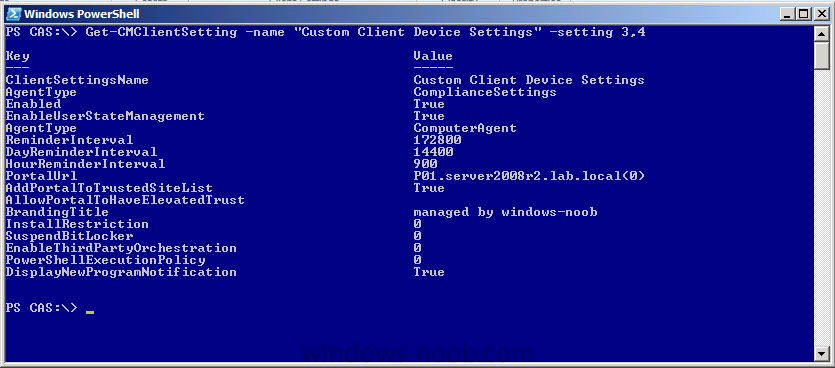

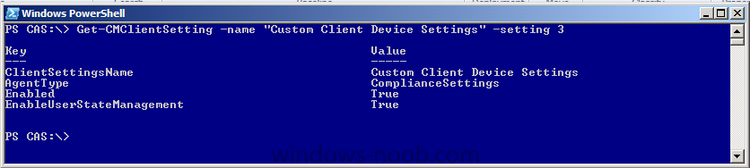

Method #1 - Verify the Custom Client Device Settings in Powershell
In a Configuration Manager PowerShell console issue the following command
Get-CMClientSetting -Name "Custom Client Device Settings" -Setting 3
It should output something like the below if any valid Client setting is found
Tip: You can change the -Setting value to an array of values between 0-18 to match the relative Agent type. For example the 3rd agent type is Compliance Settings and the 4th agent type is Computer Agent. You can specify them in any order you want them outputted in, from 0 to 18, like 0,3,2,4,5,7,10,18
Get-CMClientSetting -Name "Custom Client Device Settings" -Setting 3,4

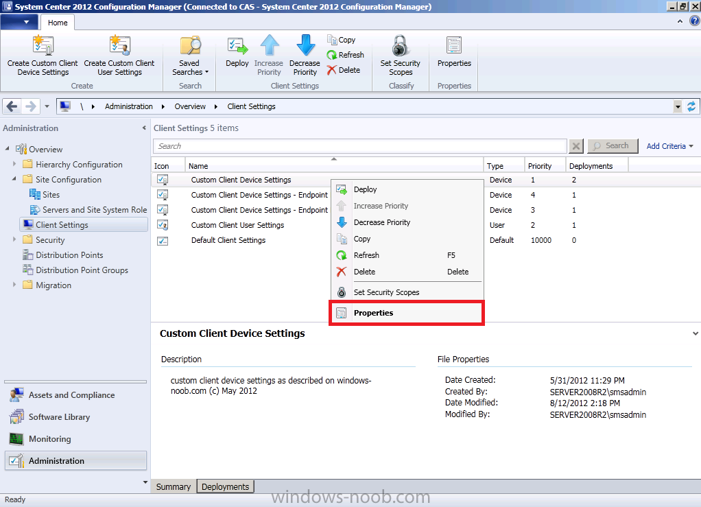

Method #2 - Verify the Custom Client Device Settings in the Configuration Manager console

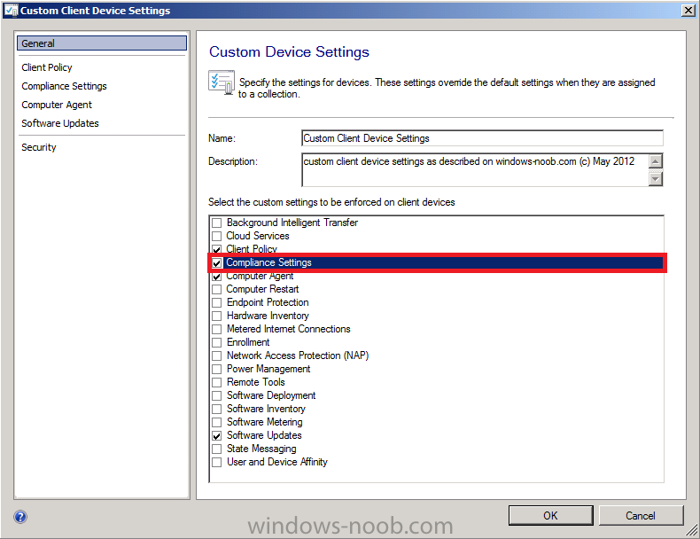

In the Administration workspace, select our Custom Client Device Settings, right click and choose Properties.

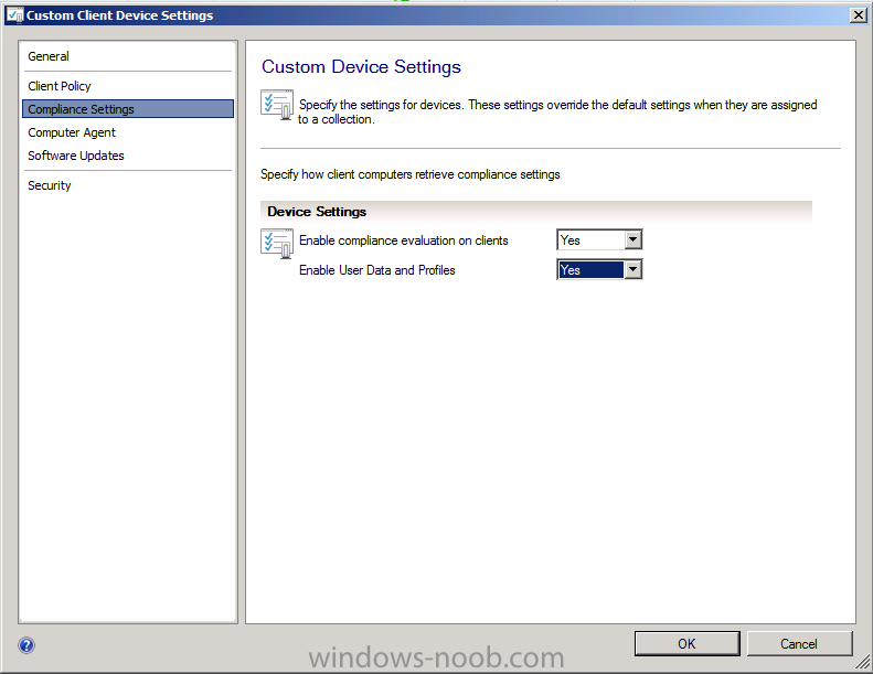

From the list that appears place a checkmark in Compliance Settings
and set both options to Yes as per the screenshot below.
Note: Enabling the Compliance Settings client settings makes it possible for Configuration Manager clients that are assigned to this site to evaluate compliance with assigned configuration baselines. This client setting is enabled by default via the Default Client Settings, but the client will not evaluate its compliance until it downloads one or more configuration baselines and evaluates them at the configured schedule. Disabling the Compliance Settings client settings prevents Configuration Manager clients that are assigned to this site from evaluating compliance with deployed configuration baselines.

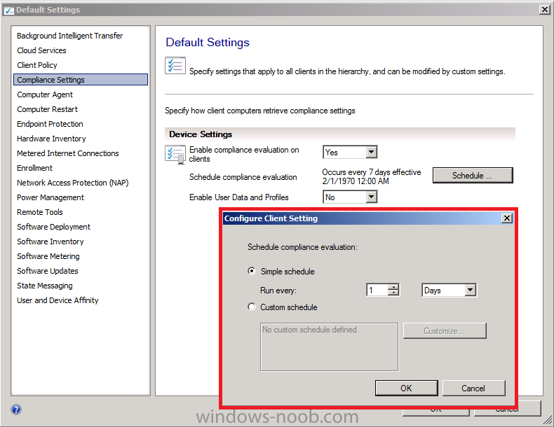

Note: The option Enable User Data and Profiles is for Configuration Manager 2012 SP1 only and applies to Windows 8 computers in your hierarchy.
If you want to change the schedule of when compliance is evaluated then you'll need to edit the Default Client Settings, and open the corresponding compliance settings option listed below, for the purpose of this guide let's change it to every 1 day (by default it's every 7 days).

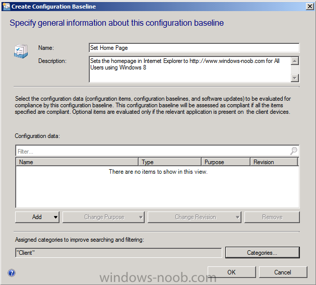

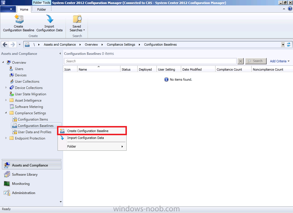

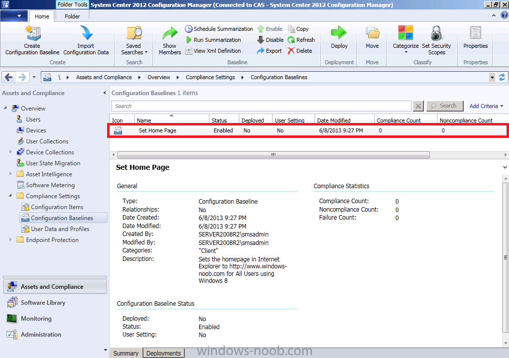

Method #2 - Create the Baseline in the Configuration Manager console
To create the Configuration Baseline using the Configuration Manager console, in Assets and Compliance right click on Configuration Baselines in Compliance Settings, and choose Create Baseline.
enter the following info, give it a name, description and select the Client category (or create a new one if you wish), at this point we won't select any configuration item.
save your settings and your baseline appears in the console.

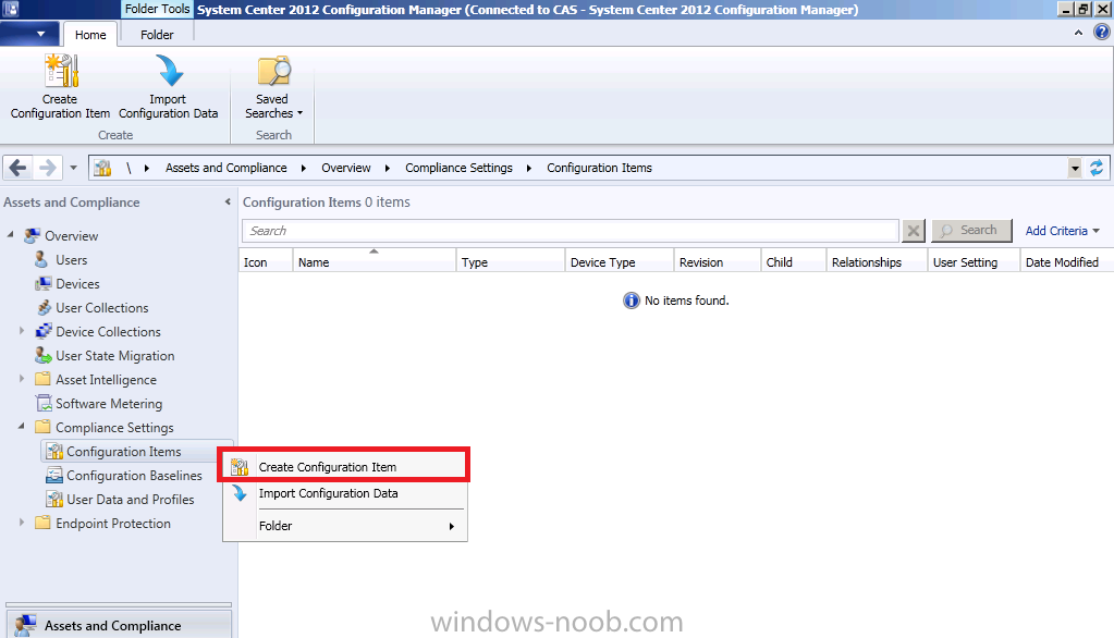

Method #2 - Create the Configuration Item in the Configuration Manager console
To create the Configuration Item using the Configuration Manager console, in Assets and Compliance right click on Configuration Item in Compliance Settings, and choose Create Configuration Item.

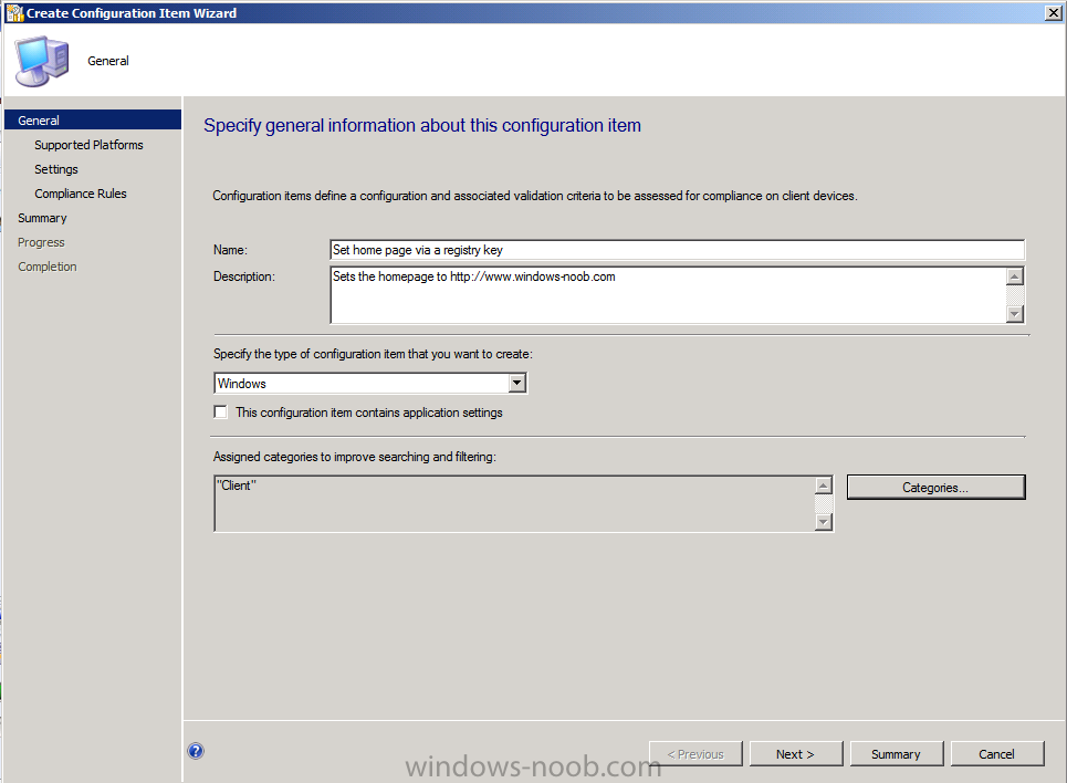

fill in the name, and a good description, select Windows as the OS and Client as the category

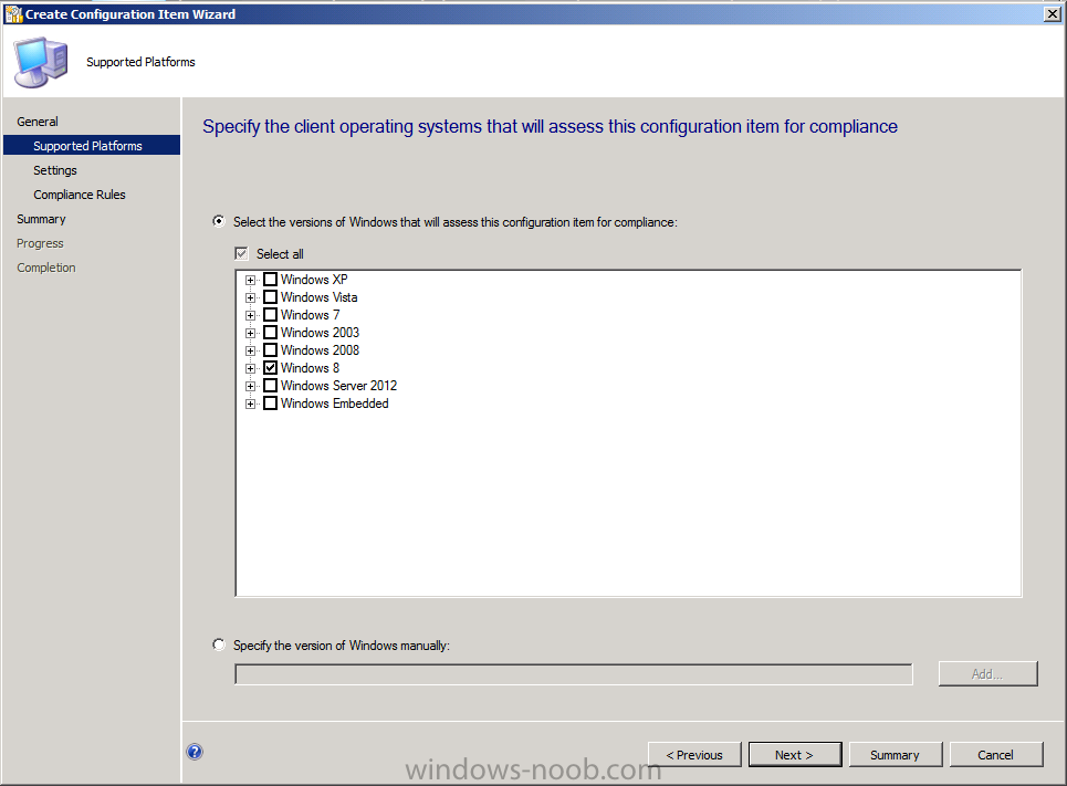

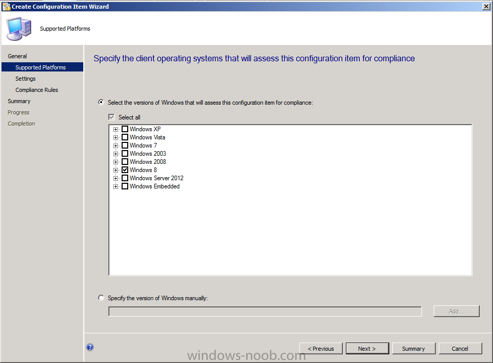

next for supported platforms deselect All and place a checkmark in Windows 8 (this will mean that the CI is only supported on Windows 8 systems)

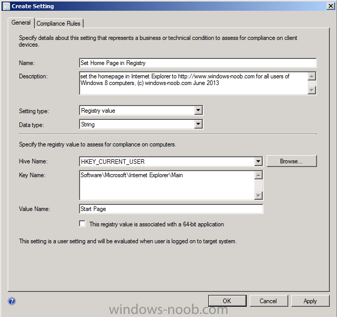

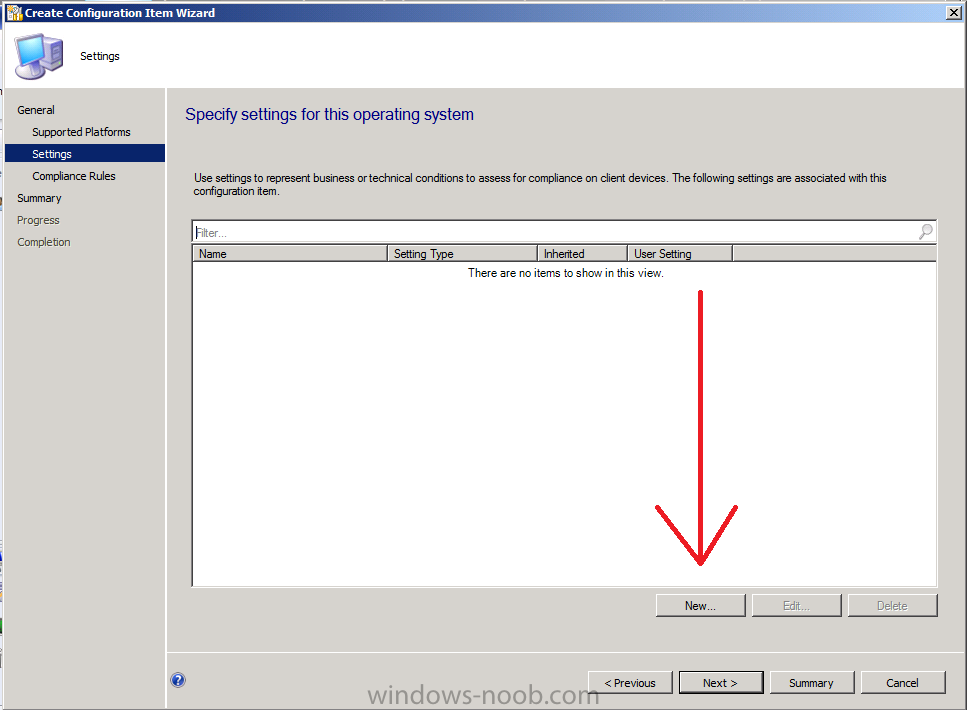

and on the Settings page click on New to create a new setting
on the Create Setting page, fill in details about the setting you are creating, when creating settings you can select the following types of setting type
  • Active Directory Query
  • Assembly
  • File System
  • IIS metabase
  • Registry key
  • Registry Value
  • Script
  • SQL query
  • WQL query
  • XPath query
we are going to set a registry key in the Current User Hive, so select the following:-
  • Hive Name: HKEY_CURRENT_USER\
  • Key Name: Software\Microsoft\Internet Explorer\Main
  • Value Name: Start Page

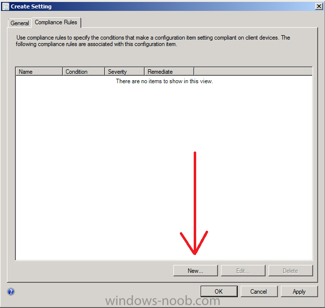

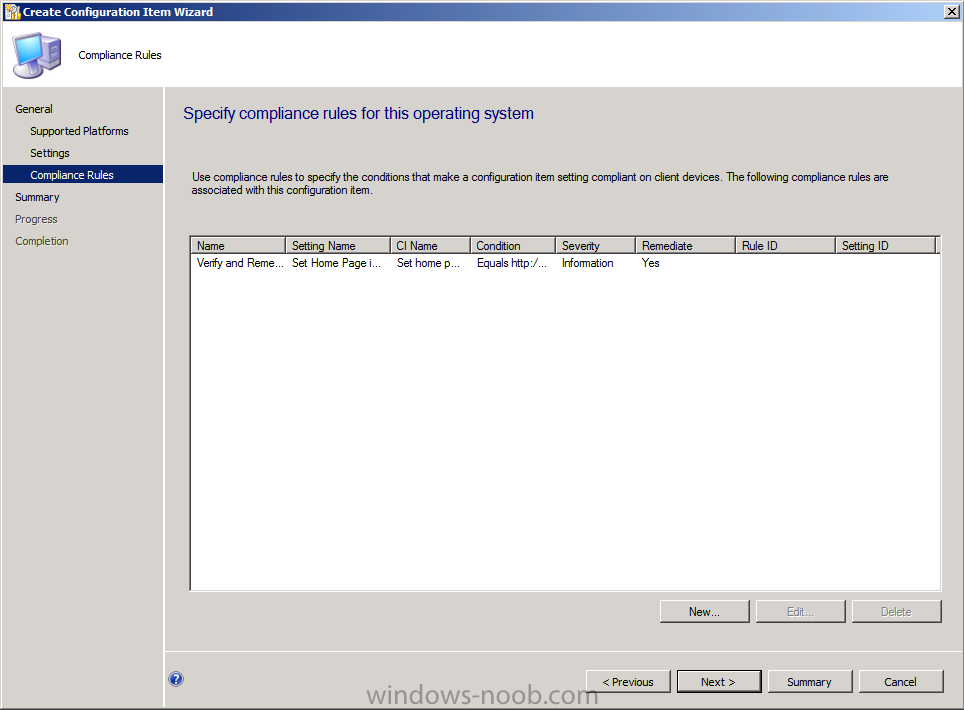

Next, click on the Compliance Rules Tab and click on New

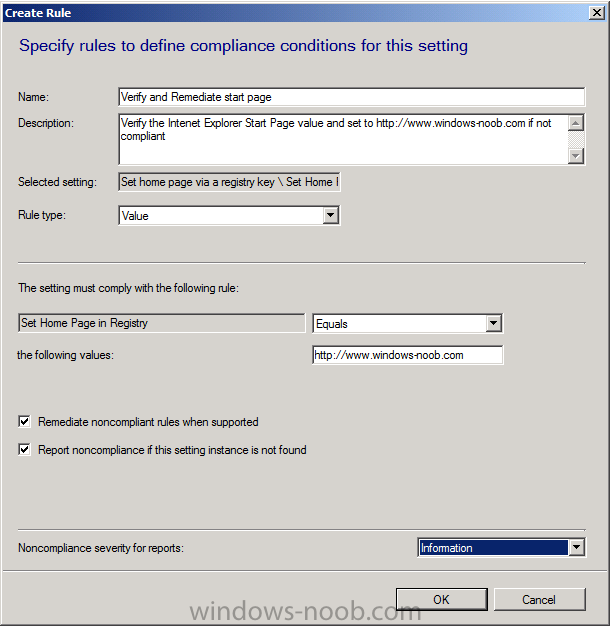

On the Create Rule page, fill in the following details:-
  • Name=Verify and Remediate start page
  • Description=Verify the Internet Explorer start Page value and set to http://www.windows-noob.com if not compliant
  • Selected Setting=Set home page via a registry key \ set home...
  • Rule Type=Value
  • Remediate noncompliant rules when supported=True
  • Report noncompliance if this setting instance is not found=True
Apply your settings and click next to continue at the compliance rules page

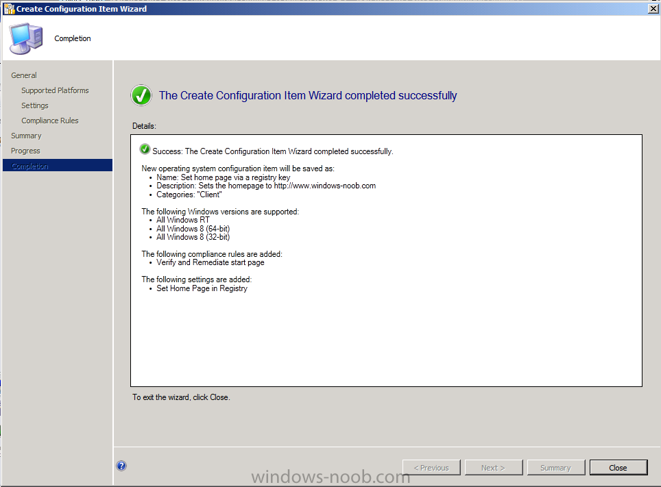

continue through the wizard until the Create Configuration Item wizard is complete

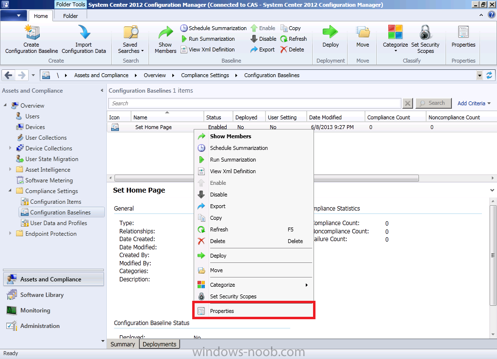

Method #2 - Add the Configuration Item to the Configuration Baseline in the Configuration Manager console

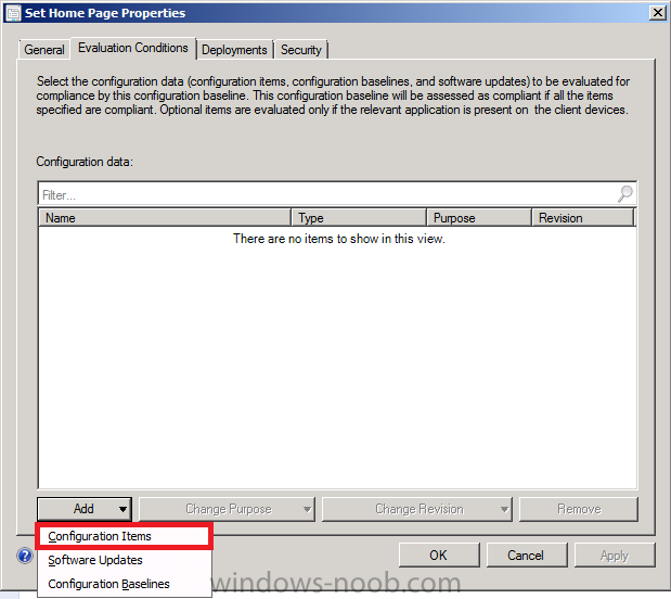

Select the Set Home Page baseline in Configuration Baselines and right click, choose Properties.
click on the Evaluation Conditions tab and in the drop down Add menu select Configuration Items
select our newly created Configuration Item, click Add then click OK
Once done click on Apply then OK.

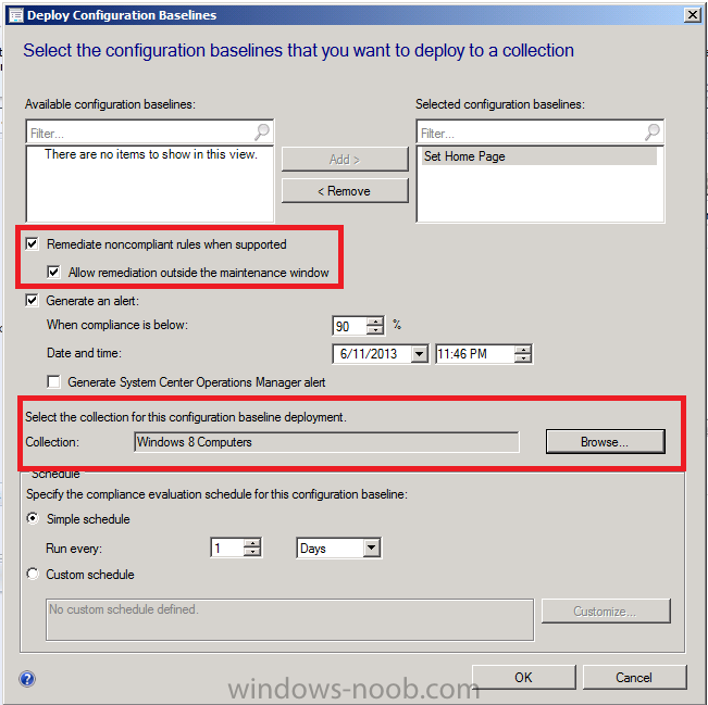

Step 5. Deploy the Baseline
Perform the following on the CAS server as SMSadmin
Now that our Configuration Item is created and added to our Configuration Baseline, we want to Deploy the baseline to a collection. As we are targeting to the Windows 8 computers collection (I've created that device collection in advance using a query to check for Windows 8 as the operating system), all computers in this collection will get this Baseline when they next poll for policy and they'll be checked for compliance. Carefully targeting your collections will mean that the compliance data returned will be more meaningful.
Method #1 - Deploy the Configuration Baseline in Powershell
We will use the powershell cmdlet Start-CmBaselineDeployment to deploy our configuration baseline.
Start-CmBaselineDeployment  -Name "Set Home Page" -CollectionName "Windows 8 Computers" -EnableEnforcement $True -OverrideServiceWindow $True -GenerateAlert $True -ParameterValue 90

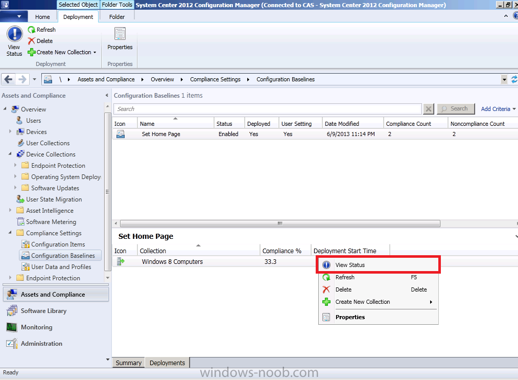

Method #2 - Deploy the Configuration Baseline in the Configuration Manager console
Right click on our Configuration Baseline and choose Deploy, fill in the values as you see in the screenshot below.

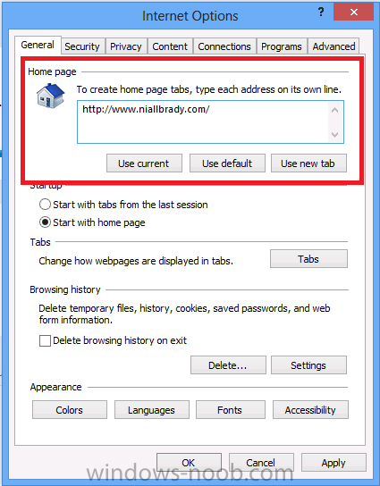

Logon to a Windows 8 client and start up Internet Explorer, set the homepage to a value such as http://www.niallbrady.com

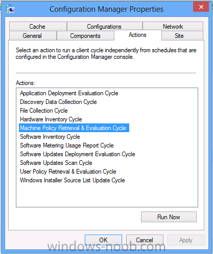

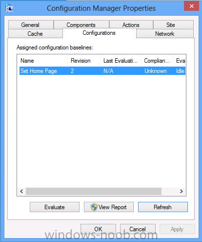

Apply the settings and open the Configuration Manager Client. Browse to the Actions tab and initiate a Machine policy retrieval.

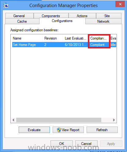

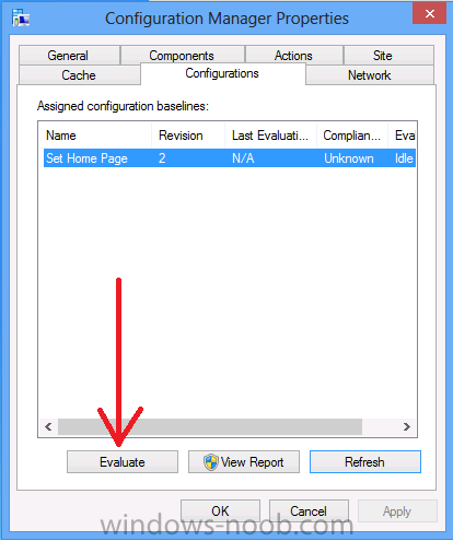

Once done, select the Configurations Tab and click on refresh, our Baseline should appear and if it has not run yet the compliance level will be unknown.

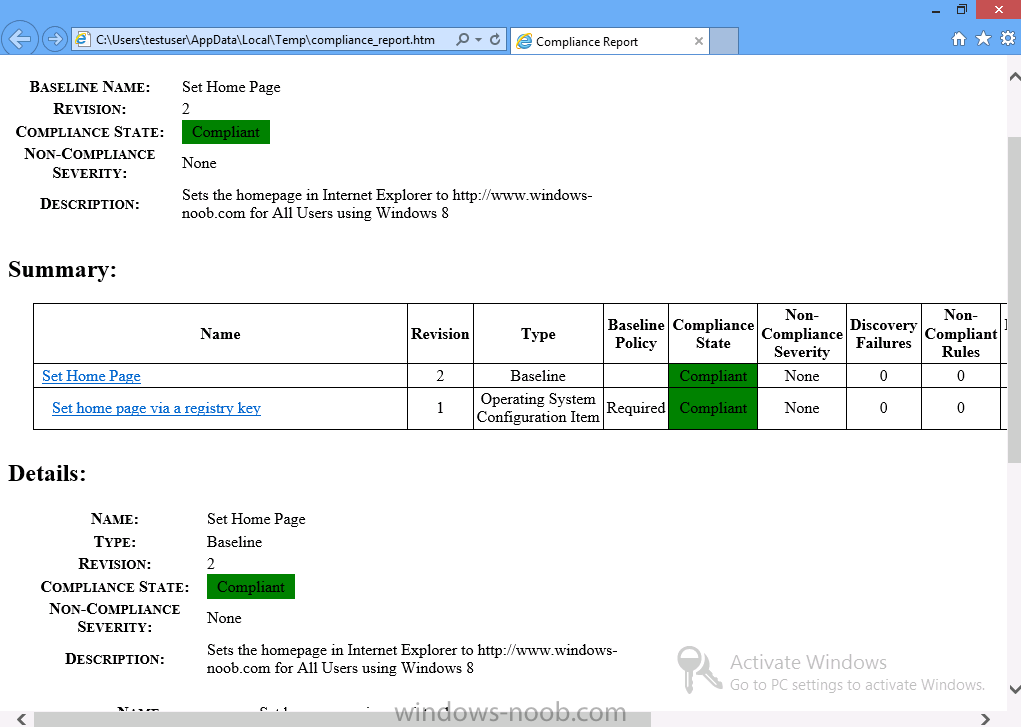

select our baseline and click on Evaluate to check our compliance
After it has run (it is quick) you'll see that we are compliant.

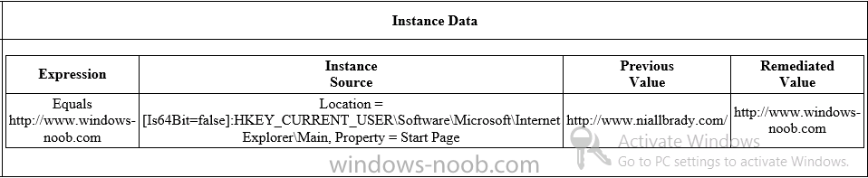

go ahead and click on View Report to see a report of what it has just done
and scroll down to see more details of what the previous value was and what it was remediated to

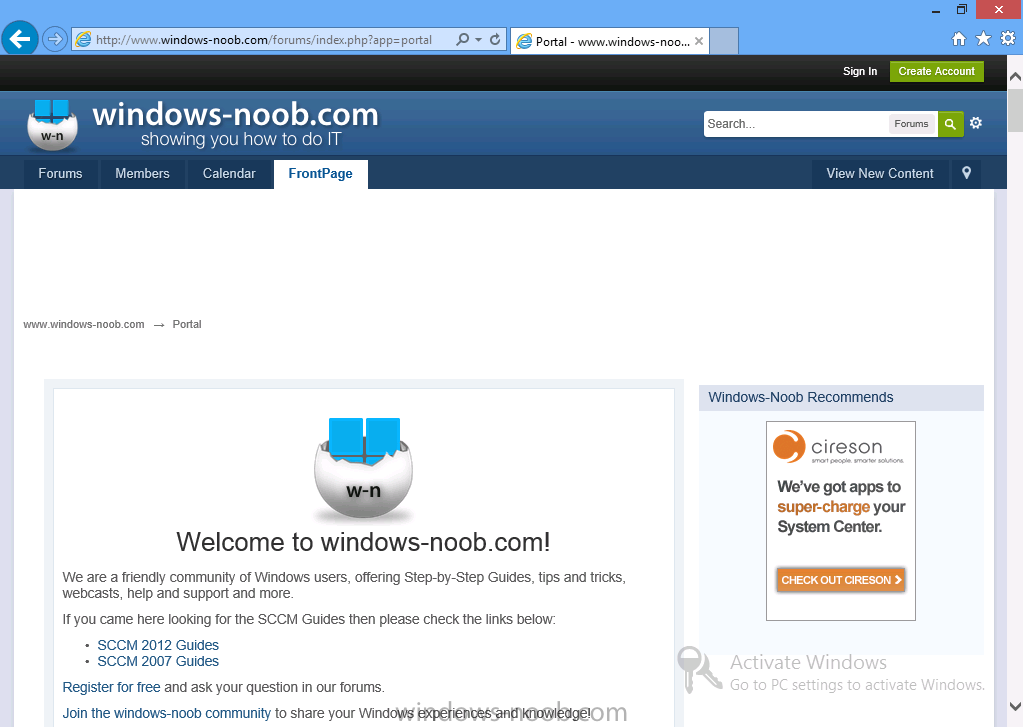

and of course you can browse to the homepage in Internet Explorer to see that our Configuration Baseline is working, it is ! Job Done !.

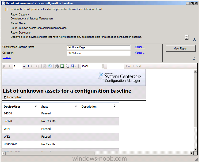

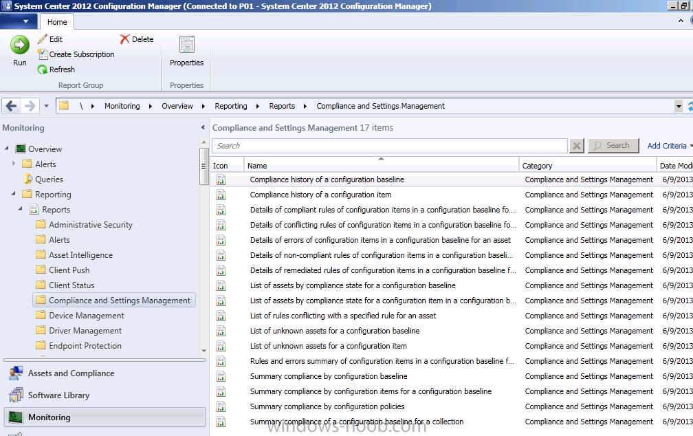

You can also review built in Compliance and Settings Management reports to get details of compliance levels in your organization
You can drill down into those reports once the state messages have been processed

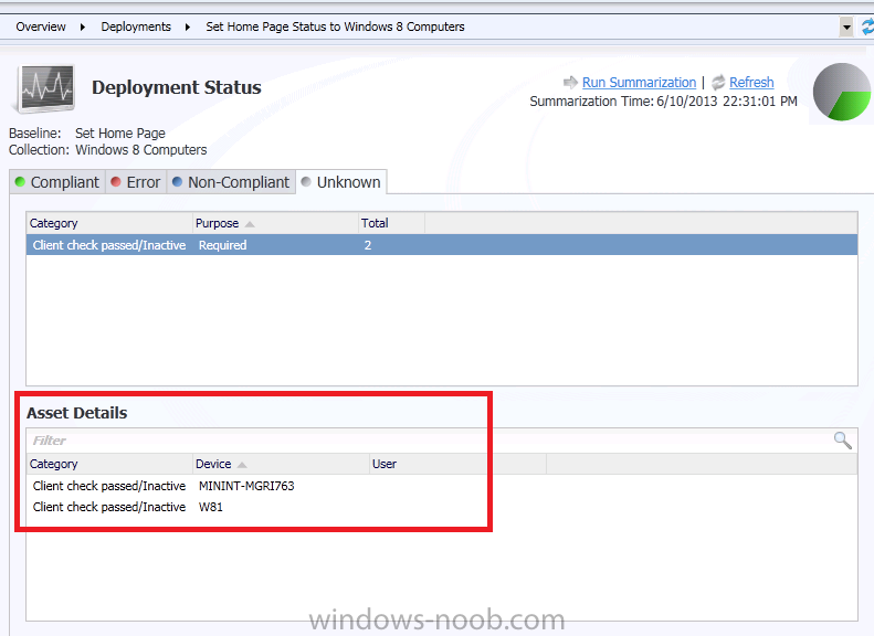

Or you can check the compliance level from the Deployments node in Monitoring, or via the Configuration Baseline itself by selecting the Deployments tab, you will see the compliance level, you can run a summarization to get up to date results or click on View status to get more information about the deployment
and check the Error, Non-Compliant or Unknown tabs for details of why they are not compliant
