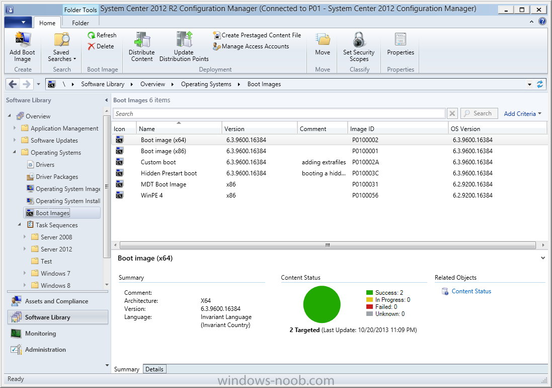

I ran the "Create MDT Task Sequence" and recreated the Boot Images and MDT Toolkit as described bellow. Now the version is 6.3.9200.16384. I had no errors in the upgrade log so I don't know what appened but it seems my upgrade wasn't 100%.

ERROR: Failed to update the default boot image: \\BRAIN\root\sms\site_OTT:SMS_BootImagePackage.PackageID="OTT00005". Error code 0x80041001 Configuration Manager Setup 22/10/2013 12:01:19 PM 12280 (0x2FF8)
WARN: Setup does not upgrade customized boot image package. Please update it manually.
I'm ok with updating the Boot Images and MDT Toolkit Package manually but I still have an issue with MDT integration:
