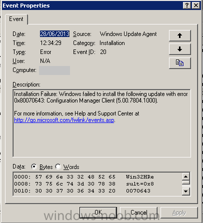

And secondly, I have tried to use the Update Distribution point to install clients for SCCM. 99% have worked and are installed.
We run, Windows XP SP3, W7 SP1, Windows Server 2003 R2 SP2, Windows Server 2008, Windows Server 2008 R2.
All of the clients install except for the 2003 servers. They just fail.
I have looked it up as much as I can, and I cannot seem to get anywhere.
I have reinstalled all of .NET (as per a suggestion linked to this subject on other forums), but it seems that no one has exactly the same problem I have.
SCCM runs without any issues, and only fails on these clients. It can see them in the console, just says it's not installed.
I have attached the Ccm log for this:

I have also installed this hotfix, but all it did was add a change to the client, but it hasn't deployed it or anything. I have tried to install it manually using the file it created, but says N/A.
