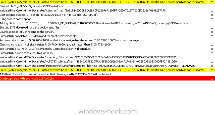

I recently upgraded my SCCM server to 2012 SP1 CU2, since then I've had a problem installing the CM client. Fails on a manual install. I've redistributed, then validated the package and all is good, however when I run the install, in the CCMsetup log it's showing a hash mismatch for the SCEPInstall.exe. There have been a few posts kicking around but not how how to fix this. when it runs I can see it references the default SCCM Client install package and as this can't be deleted\ modified etc, I know I have a problem.
Anyone know how to correct this???
pic attached showing error....
