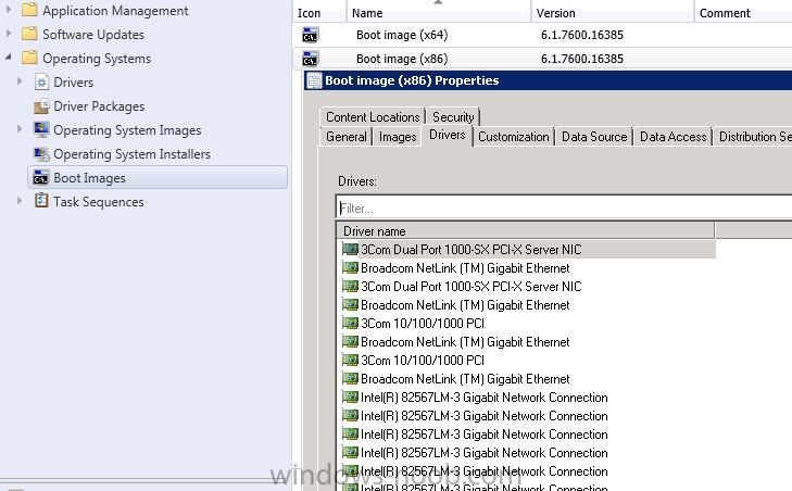

0 Rocket Man Posted July 26, 2013 Report post Posted July 26, 2013 It could be that your new boot.wim file is missing some drivers that were injected into the boot.wim you were previously using. Check your original boot.wim that you were using to see what drivers are present in it. Then check to make sure that your present boot.wim has same drivers...if not add them also to the wim file. Quote Share this post Link to post Share on other sites More sharing options...
0 Ganesh.Prajapati Posted July 26, 2013 Report post Posted July 26, 2013 Thanks, Boot image issue is resovle and it is processing the task sequences but in task sequence after reboot the system gives bootmgr missing issue on physical system. The system is at remote place so i can not go and get the logs. Very limited support from client. Can you tell me what can be the issue. Thanks, Ganesh Prajapati Quote Share this post Link to post Share on other sites More sharing options...
