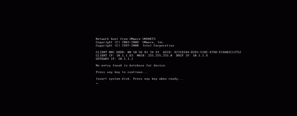

I have a lab With one DC (also a DHCP) and one server With SCCM 2012 SP1 and SQL 2012. I have enabled the pxe-option and also made the boot images available to pxe.
But when i am trying to do a pxe-boot from both a vmware Virtual machine and also from a physical computer i get the same Message. The Messages says "No entry found in database for Device". The SCCM, DHCP, and Clients are all on the same subnet.

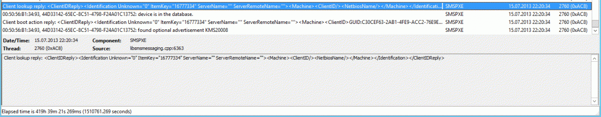

I have enclosed the SMSPXE.log and the Message the Clients get trying to pxe.
Can somebody please point me in the right direction?
