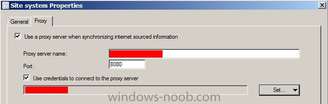

Internet access is via proxy which is configured under "Site System" settings.
IE browser is having proxy address configured and I am able to access internet with the account that is configured under Site system properties

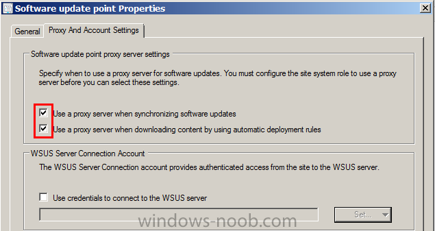

Under SUP settings
I had "Use proxy server when sync software updates" selected, but "Use proxy server when downloading content by using Automatic deployment rules" was unchecked when I Run the ADR.
Now I have enabled that option, but the logs are still showing up the errors mentioned above.
I guess I will have to stop the on going process 1st then re-run the Rule again to get the new settings, or may be something else.
Please give your inputs to make it right.

I had this exact problem and this didn't fix the problem. I got lucky and decided to search the registry for my proxy because I cleared it out of everywhere I could think of. Sure enough I found it in a SMS reg key. Then I cleared it and and now my ADR's are working correctly. I had to put my servers on a different vlan so they have a direct connection now, no proxy but oh well at least they work.
