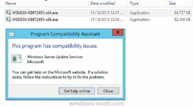

rezachin Posted January 8, 2014 Report post Posted January 8, 2014 I got the same problem! :angry: I got it from here (he has great SCCM 2012 R2 blogs) : http://prajwaldesai.com/installing-wsus-for-configuration-manager-2012-r2/ Is WSUS 3.0 SP2 required on SCCM 2012 R2 running Windows Server 2012 R2 standard? WSUS 3.0 Service Pack 2 is required for System Center 2012 R2 Configuration Manager. SCCM 2012 R2 supports only 64-bit site systems, you must use the 64-bit version of WSUS on one of the supported 64-bit editions of Windows Server. The WSUS 3.0 SP2 is available here:- http://www.microsoft.com/en-us/download/details.aspx?id=5216But when I tried to install it on Windows Server 2012 R2 Standard before adding WSUS role and before installing SCCM 2012 R2 on that box. I'm stuck...WSUS30-KB972455-x64.exe (double click to install it)This program has compatibility issues, Windows Server Update Services Microsoft. Click button: Get help online Quote Share this post Link to post Share on other sites More sharing options...
