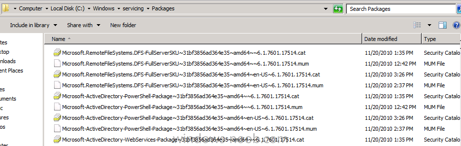

2. (Review DISM1.png) You can see an E_ACCESSDENIED and an ERROR_FILE_NOT_FOUND at the same time offline servicing broke during the scheduled updates. Thinking it's a permissions issue, I ran a search for KB2691442 (referenced in the OfflineServicingMgr1.png before the first failure) on the C:\ drive of my primary site server to see what I could find. The results of my search all pointed to C:\Windows\Servicing\Packages (Directory.png). It would be helpful if anyone could provide information on the relevance of this directory and whether or not this is the location offline servicing is looking in when it's attempting to install a selected update.

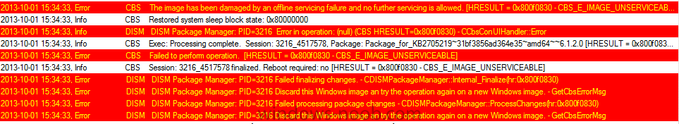

3. (Review DISM2.png) It appears that DISM is smart enough to recognize that an update failure damages the image. I assume all subsequent errors in my OfflineServicingMgr.log (ErrorCode = 2096) can be attributed to this. This is also why it's good to deselect 'continue on error' when running scheduled updates.
