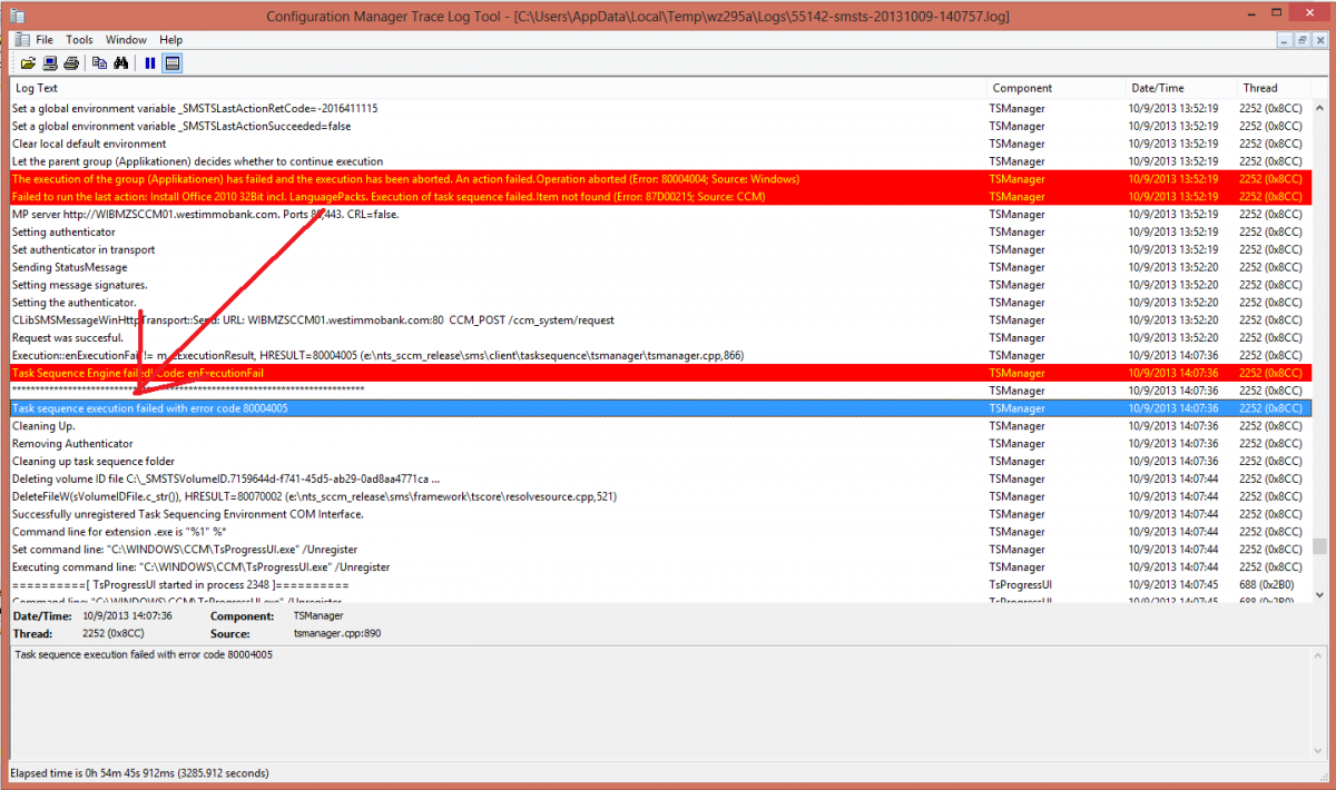

anyweb Posted October 10, 2013 Report post Posted October 10, 2013 Failed to run the action: Install Office 2010 32Bit incl. LanguagePacks. Item not found (Error: 87D00215; Source: CCM) so you should check the logfile for that package and/or verify it actually exists on the distribution points Quote Share this post Link to post Share on other sites More sharing options...
DerDa Posted October 10, 2013 Report post Posted October 10, 2013 Thanks for your answer. As said I don't think that the problem are the packages where the TS failed, because the TS succeeded with other PCs. All PCs were started with the same Task Sequence. Furthermore you can see in the smsts.log that the files for Office were downloaded (e.g. 55281-smsts-20131009-125912.log) Quote Share this post Link to post Share on other sites More sharing options...
anyweb Posted October 10, 2013 Report post Posted October 10, 2013 it is that step that is leading to the failure, look at this picture, due to the failed app install (previously it reports The sms client service is not running, that's not good....) so you need to find out why that application is failing and what is cuasing the client service to stop, without further logging it's hard to tell, your smsts.log files are not showing all the logs, you need to increase smsts logging capability as described here http://gregramsey.net/2012/12/05/how-to-enable-debug-logging-for-an-os-deployment-task-sequence/ and here http://blogs.technet.com/b/system_center_configuration_manager_operating_system_deployment_support_blog/archive/2011/10/12/how-to-change-logging-options-for-smsts-log-in-system-center-configuration-manager-2007.aspx Quote Share this post Link to post Share on other sites More sharing options...
