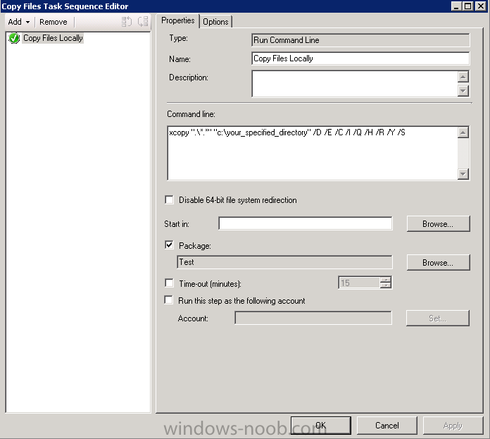

Rocket Man Posted October 16, 2013 Report post Posted October 16, 2013 Why not use a run command line step like this and simply reference the package that contains the 2 files xcopy ".\*.*" "c:\your_specified_directory" /D /E /C /I /Q /H /R /Y /S This will work without the use of scripting! Or if you dont want to do it via a task sequence a batch file (nameofbatch.bat) like this would do the trick: copy %~dp0file1 "C:\Your_specified_directory" /y copy %~dp0file2 "C:\Your_specified_directory" /y Have the 2 files in a package along with the batch file and the program command line will be nameofbatch.bat Quote Share this post Link to post Share on other sites More sharing options...
