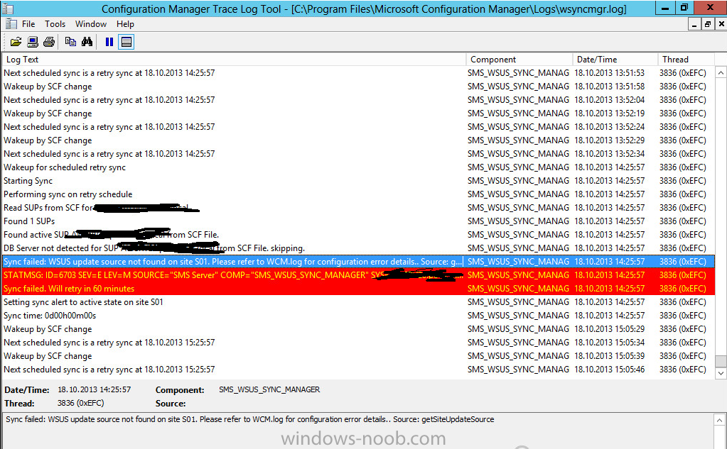

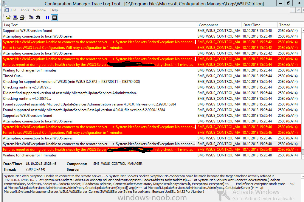

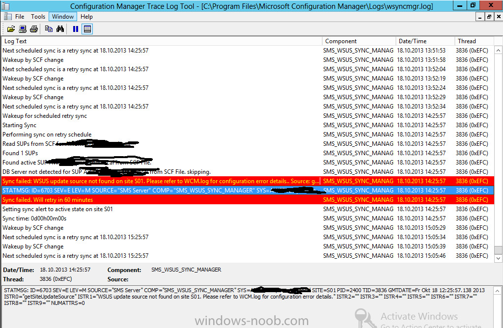

I'm busy installing sccm 2012 on a windows Server 2012 SP1 and SQL 2012
Everythink works fine, but WSUS makes problem.
first i installed all the features and the WSUS Role. (i didn't configured the WSUS. i just installed the Role)
After it i switched to the SCCM Console and added the SUP Role. then i got en error and i removed it again and again.
still the same problems.
Maybe somebody can help me to fix it ;-)
Below i have some Screenshots with the errors.

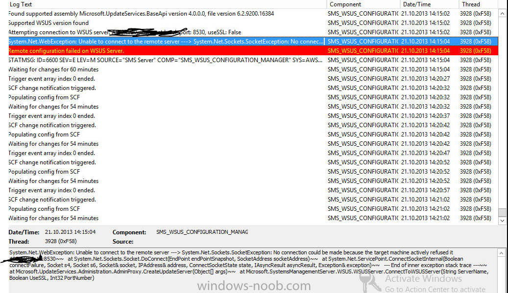

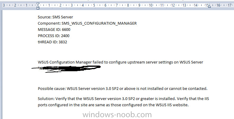

Hello
in the Properties on the SUP i see Port Number: 8530 and SSL Port Number: 8531
on the IIS Advanced Settings on the "WSUS Administration" Site is Bindings: http:*:8530: configured.
And for your information: The WSUS, IIS and SCCM are on the same Server installed

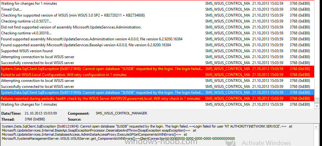

Good Morning
I solved the problem. But i'm not sure which task it fixed :-/ This morning the Patches where downloadet.
But i guess i made the following:
http://www.toolzz.com/?p=837
I had exactly the same error. After the change "manual rename" i reinstalled the WSUS and the Sup. in Windows Manager i started the WSUS to set the SQL Instance and the Patch Download folder.
The next step "Configure WSUS" i canceled.
Many thanks to everyone for your Help ;-)
