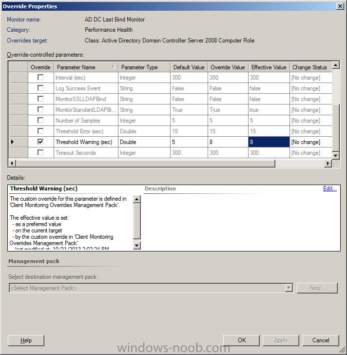

It's the AD DC Last Bind Monitor, in the v6.0.8228.0 version of the Active Directory Server 2008 and above (monitoring) management pack, that's complaining about the DC response time. The screen shot is a graph of the domain controller response time over the past 24 hours.
The warning is that the response time is higher than the default warning level of 5 seconds. I determined why this was happening; a port scanning filter included with the Windows Firewall does this.
I also found the override setting. When you bring up the Health Explorer for an alert (right click, Open, Health Explorer), you can navigate to what triggered the alert. Bringing up properties for the unhealthy item allowed me to set an override for the threshold warning, and save it in a management pack.
This doesn't solve the original problem, but at least I can have SCOM stop complaining about it. I'm asking the firewall folks why this is happening and if I can tune the port scanning filter to not be so paranoid about this.
