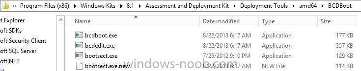

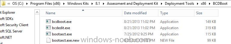

Tof006 Posted November 19, 2013 Report post Posted November 19, 2013 Here's how I did the WinPE with bootsect.exe v6.2.9200 : You can use this software to download the bootsect.exe v6.2.9200 or older if you don't have them : getwaiktools I went in the C:\Program Files (x86)\Windows Kits\8.1\Assessment and Deployment Kit\Deployment Tools\x86\BCDBoot and C:\Program Files (x86)\Windows Kits\8.1\Assessment and Deployment Kit\Deployment Tools\x64\BCDBoot Renamed bootsect.exe to bootsect.exe.new Copied the older bootsect.exe in the corresponding directories And created a new Boot Image. That's all and it works. Thanks Quote Share this post Link to post Share on other sites More sharing options...
