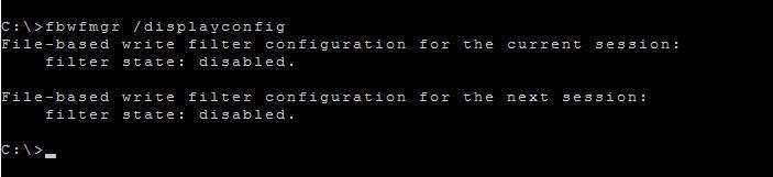

robmanx Posted November 6, 2013 Report post Posted November 6, 2013 Hello, I need to install SCCM Client on a thin client machine running window 7 embedded sp1 32x for SCCM 2012. I already tried pushing the installation and manually without luck, Attached are the ccm.log from the server and the ccmsetup.log from the machine, I already tried several troubleshooting, computer is on the domain, it has the correct admin right, firewall is turn off,....any idea? Quote Share this post Link to post Share on other sites More sharing options...
Peter van der Woude Posted November 6, 2013 Report post Posted November 6, 2013 CCM.log only shows a successful push, so that doesn't add anything in this case. CCMSetup.log shows a very clear error, which you even underlined... The Write Filter is enabled on the device and needs to be disabled before installation. Quote Share this post Link to post Share on other sites More sharing options...
robmanx Posted November 6, 2013 Report post Posted November 6, 2013 Thanks for the reply Peter, I've disabled FBWF already and you can see it on the CCMSetup.log that said "FBWF is disabled...." do I missing something? It's the first time that I am trying to install SCCM Client on a Thin Client Machine Quote Share this post Link to post Share on other sites More sharing options...
