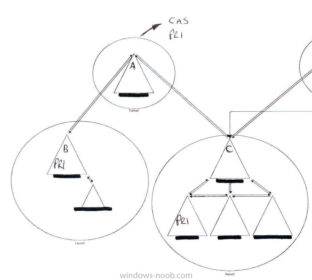

I've been trying without much success on try to implement a Multi Forest hierarchy i've attached a simple diagram of what I want to achieve.
I want forest A to have a CAS and Primary (which is working fine at present) I'm thinking Forest B to have a primary in the adult AD but this is where my problem happens forest C the AD i want to manage is a child im not interested in servicing the Adult in forest C what would be the best set-up for forest C
am i right in thinking i would be best to deploy a Primary in the Adult of the forest then a secondary in the Child AD that i want to manage within SCCM.
sorry if this sounds like a simple setup but im struggling with this one :-)
any help would be much appreciated.
if you feel my setup is wrong please advise.
