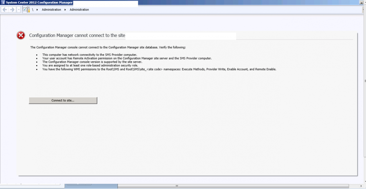

Hi guys,
I can't open my console SCCM. I don't change anything in my environment.
My checklists:
1.http://technet.microsoft.com/en-us/library/bb932213.aspx
2.Yes, I can logon in my Database in Database Management Studio
3.Permissons are OK;
4.I can ping,tracert etc between my server SCCM and server DatabaseSccm;
5. Yes, I ran AdminConsole.msi;
Open log smsadminui.log display following error:
*** [08001][11001][Microsoft]
A network-related or instance-specific error has occurred while establishing a connection to SQL Server. Server is not found or not accessible. Check if instance name is correct and if SQL Server is configured to allow remote connections. For more information see SQL Server Books Online.
So, can you help me please? Thanks.

Thanks your opinion Edenost.
Well, my console don't open in my server SCCM or other desktop have installed console SCCM.
About second question, really I don't remember, but I installed best practices Microsoft and my SCCM ran last months normally.[
My firewall is disable 3 options (domain,public...).
I will check this link.
I read this probably error DNS, I'm check this too.
Thanks.
