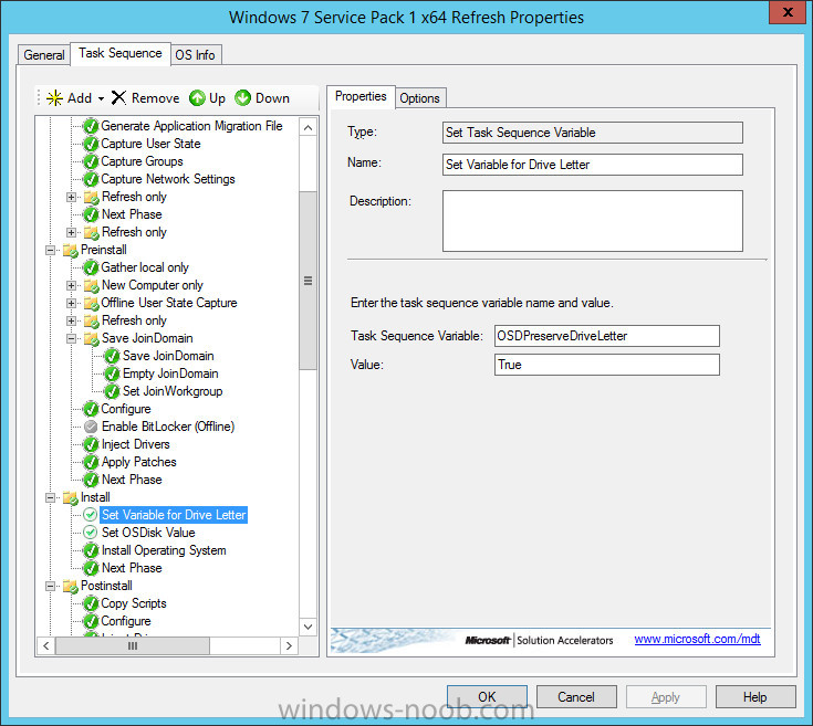

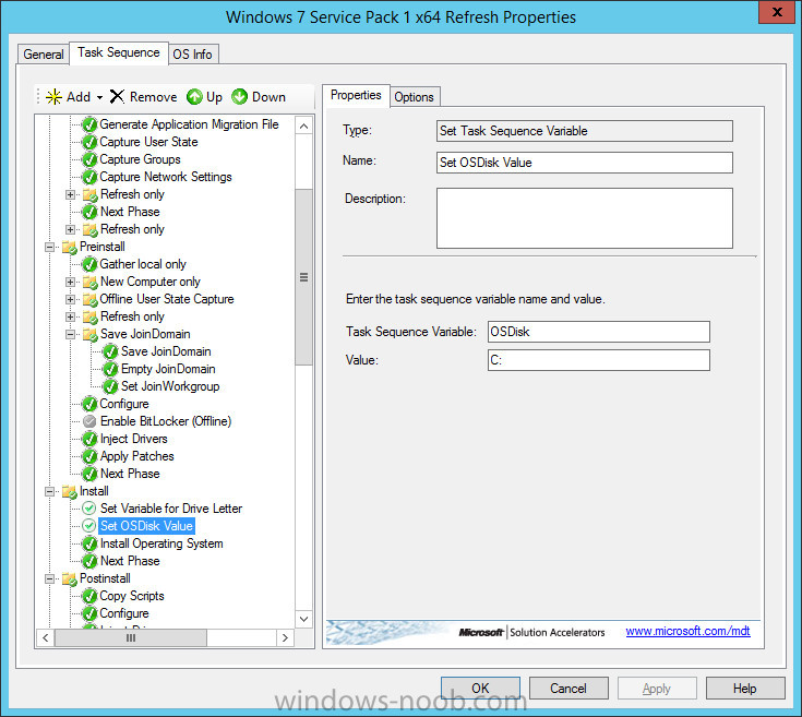

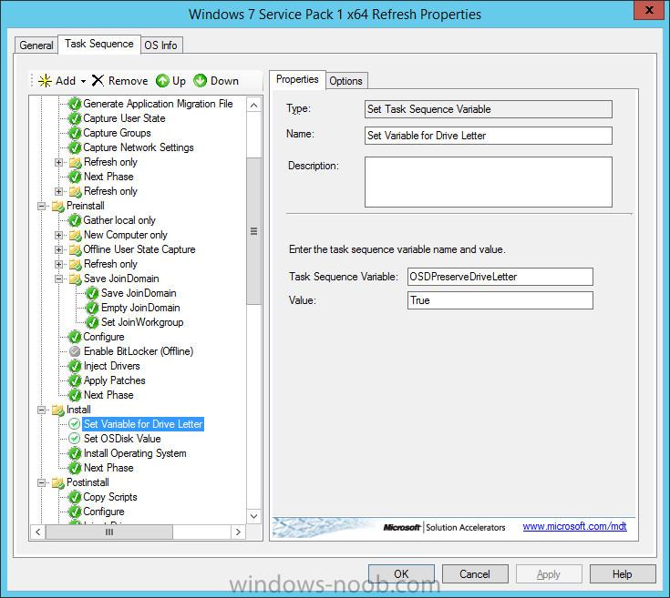

Not sure if this will help or not but try adding a step in your MDT TS which sets the OSDPreserverDriveLetter to True and a step directly after this which sets the OSDisk variable to c:
I have uploaded some screen shots of where I have these steps in my MDT TS. I am running this TS to refresh XP to Win 7 so I'm not sure if having these steps will resolve your problem.
